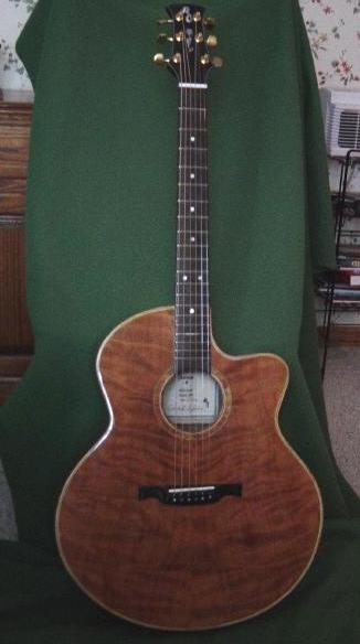

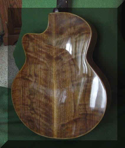

Bruce here's one that I did exactly that. Jumbo 17" body with OM thickness. The redwood top is a bit boomy but still quite nice. I tend to agree with Dave on the carpathian top.

Bob - Nice looking guitar. Walnut? How does it feel when sitting? Does the narrow depth give the impression of holding a smaller guitar?

Bruce it does feel very comfortable with the thinner body. The b/s are black walnut. I don't play with a pick and it is very responsive to finger picking. Now as for the J-200 I made one in curly maple for a friend of mine who has been playing for at least 30 years. He claims it's the best guitar he ever owned. Go figure. Maybe it's because Gibson didn't build it.
